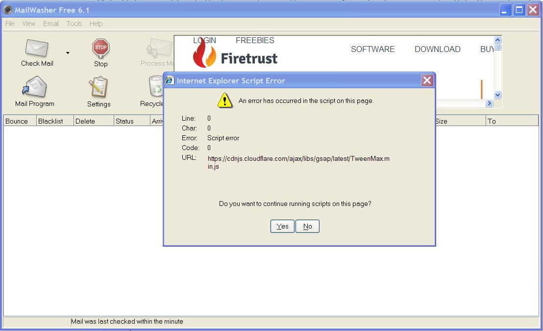

I am still getting the script error. Using M/W Free 6.1 on XP-Pro, IE 8. Chrome is my default browser.
Attached is a screenshot: As reported in this thread, error just started early today 5/27/16.
I have cleared cache and temp files and rebooted, but script error still occurs. I have script error notifications turned off in Internet Options. Still appears to be on Firetrust's end.
--RonR
MW6-1 ScriptError-16e27.jpg (62.85 KiB) Viewed 15959 times

Can you download and install MailWasher Free 6.5.4, that will correct this problem
http://cdn.firetrust.com/downloads/mail ... _Setup.exe

When I first tried to update MW 6.1 to MW 6.5.4, I got install errors. It launched okay, but did not preserve my settings. I remember now, this is why I didn't update before.
Did some investigation and discovered MY installation of MW FREE 6.1 used Ap Data Folder "MailwasherPRO" and HKCU Registry Key named "Mailwasher Pro." Don't know if this is a corrupt installation or normal after free trial, or something.
In any case, I rolled back (using my disk image) to the previous MW6.1 installation. I then shut down MW and renamed the Ap folder and Reg Key to "MailwaherFREE" and "Mailwasher FREE," respectively. Then MW 6.5.4 installed without a hitch with ALL my Filters and other settings intact! So far, everything is great -- and NO MORE Script Error. -RonR
