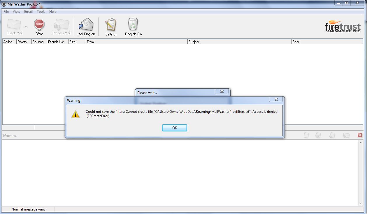

But every time I close my MW 6.5.4. a pop up shows up that I dont understand about a txt file wasnt found
yada yada.. filters.txt and Access is denied.
I just click ok and it's gone till I need to close it again. I have a photo of the pop up but I cant find where to post it so you can see what I'm talking about.
Oh, there it is. Check the photo and tell me how to fix this.
I've been using it this way for many years. I thought maybe I'll try to fix this. What do you think?
Thank you.

If you click on Help >> About >> open the link to where MailWasher stores the data files >> right click on filters.txt and select Properties >> make sure ReadOnly is not checked, if it is, uncheck then click OK.
That will hopefully stop these popups.
