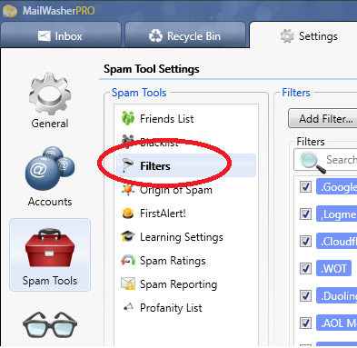

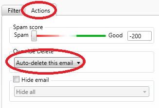

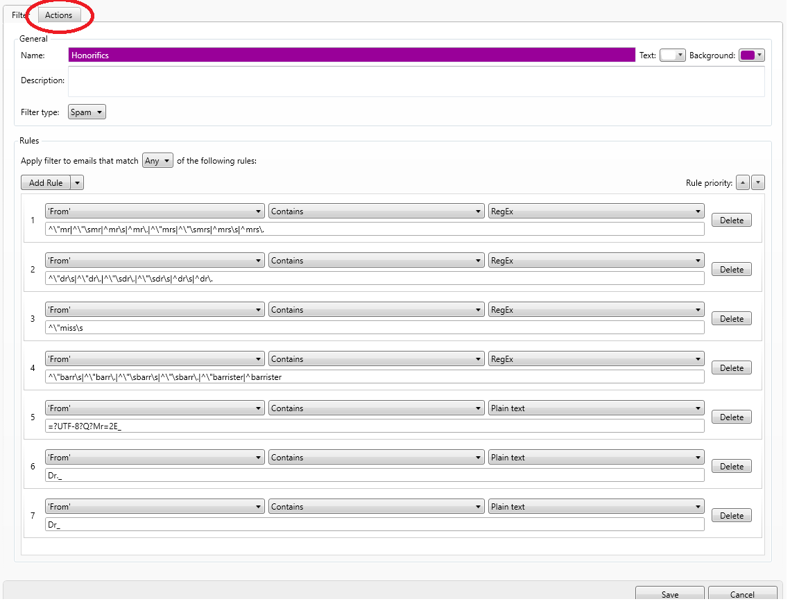

You need to open the filter that caught the spam and choose the "Action" setting to delete automatically.
Use it judiciously; it can be hard to predict what might get deleted. Best to only activate it after having used the filter to mark things for manual delete for a while.
