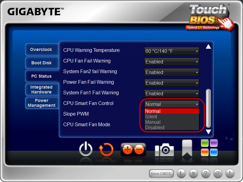

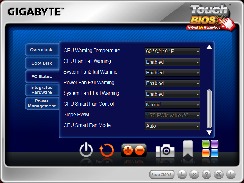

@ Victor Kish
What's the full description name of your BIOS? Here's a lil' example of what your BIOS can accomplish:-
