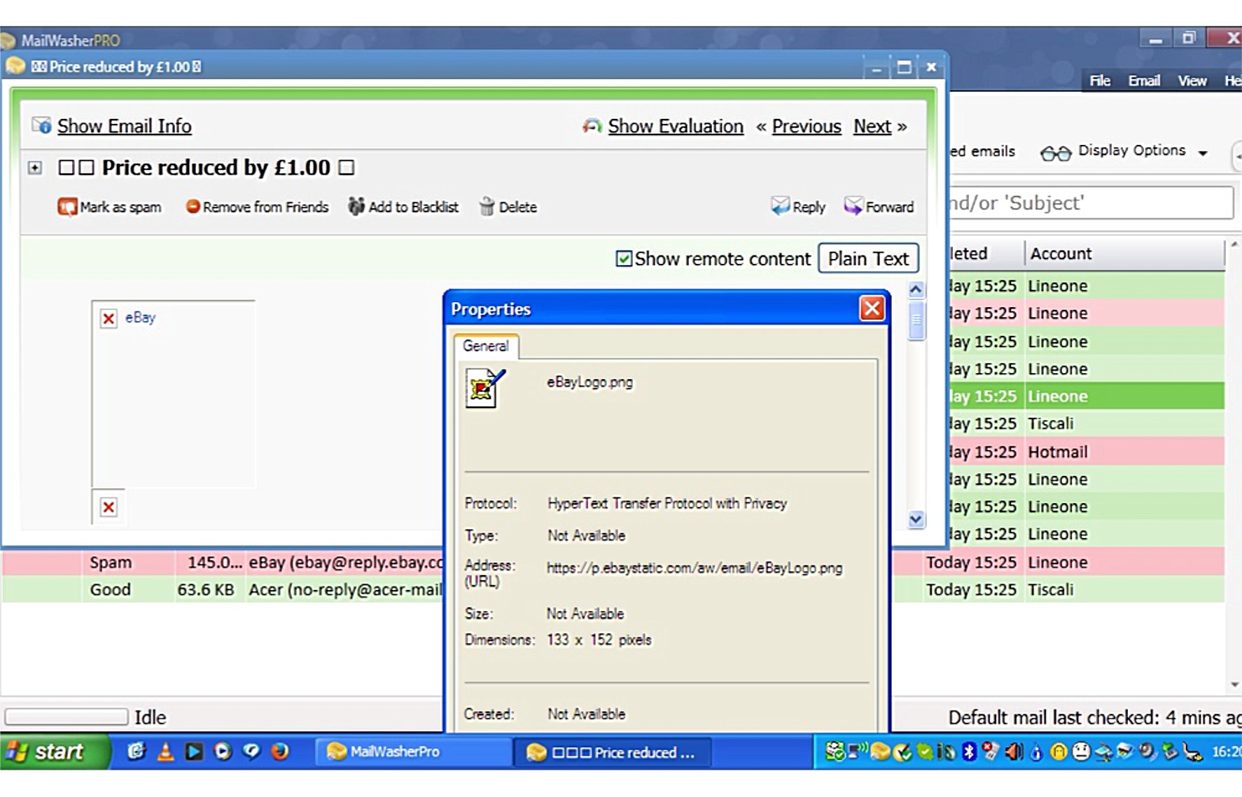

Basically, if I view an email either in Mailwasher or Outlook Express, any .png type images appear as an outline box with a red 'X' in the top left hand corner. (Please see attached screen dump).

- screen dump.jpg (303.25 KiB) Viewed 23633 times

In Outlook Express try going into Tools >> Options >> select the Security tab >> there should be an option there about blocking external content/images that you can disable.
That may however have potential to create vulnerabilities on the machine, given both the OS and email client you use are no longer being patched. You've got a decent AntiVirus program, so just consider your important files etc.. are backed up somewhere.

Re: Any ideas why .png files not displaying in Outlook Express?
Many thanks for your speedy reply to my post, much appreciated.
I have already checked the settings in Outlook Express and they are fine, so unfortunately it must be something else.
As I mentioned in my post, the same problem exists in Mailwasher so I guess it must be a setting somewhere which affects both programs.
I'm currently removing and re-installing Norton just in case there is a block there somewhere, but not holding out much hope.
Outlook Express and MailWasher both use an IE based framework for rendering HTML. So there could be something in your Internet Explorer settings that might be causing this. I don't have access to an XP machine anymore unfortunately, so it's a lot of guess work.
Clearning temp files may help
I can find a few posts from users with the same issue, but none of them have any solution with it
I'd also run a Disk Cleanup from the Administrative Tools to be sure your TEMP folders aren't full.For IE6:
Clear the Temporary Internet Files: In IE | Tools | Internet Options |
Delete Files button. And check the box to Delete Offline content.
Thanks again for your speedy reply.
I did wonder if it could be an IE problem as I suspected Outlook Express used that framework (Microsoft......).
I have already cleared the temp files manually but I will try your suggestion of deleting through Internet Options - good idea!
Update to my previous post.
I have done the deletes through Internet Options and run Microsoft's Disk Cleanup and also from Norton Utilities.
Sorry to say this has made no difference and the error remains so still at a loss here.
I do appreciate your help with this but please don't worry too much, it's only a cosmetic problem really.
Regards, arglet
Install the last working version of Java for your platform — current version for other platforms won't work.
Navigate to the Control Panel >>----> Internet Options >>----> Advanced >>----> Multimedia >>----> enable (tick) Show Pictures >>----> disable (un-tick) Show image download placeholders.
Hello,
Thank you for your input on this problem,
I have already checked the settings you have suggested and I can confirm that I am running Java 7-72 (final XP version) and that Internet Options are as you have stated.
This error only appears for both HTTP with privacy and .png file types. Everything else is working correctly, i.e. HTTP with privacy and .jpg works fine and HTTP with .png also works correctly.
