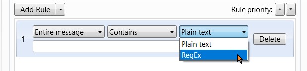

My apologies, I'm sure this question has been covered somewhere but, I was unable to find it. When setting up a filter can you add more than one word to a line? Such as (example), as, the, Jim, Bob, cops? OR, can only one word be in one line? Should I use "AND", "OR", etc. between words?
Thanks...Dave

Hi Dave,
Yes, that is no problem, if the filter is a plain text filter, MWPro catches the exact wording of whatever you write in there, so you'd need one word/phrase per filter rule.
However, if you want MWpro to catch a bunch of words, instead of plain text, select regex from the last box:
Then you can place a pipe, eg: | between each word so MWPro will search for each word by itself, eg:
Regex filtering is pretty specialized but works really well once you get your head around it..... this page is pretty good from these forums:
http://forum.firetrust.com/viewtopic.ph ... a757b8635b
Cheers!
