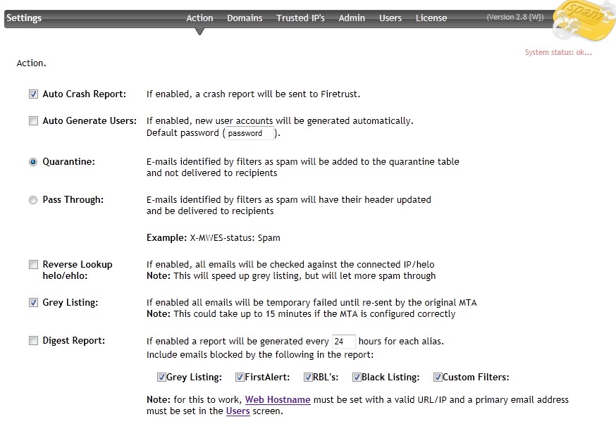

Re: Are receiving considerably more SPAM than normal
Hi Cliff, i am using 2.8, and i can't find any newer version on your website, not sure what to upgrade too ?
Also i am confused what you mean by clearing the Greylist friend cache, I can't find the option you are referring too, do you want me to disable the "Grey listing" ?

- cliff
Cliff, I still don't know how to clear the "greylist friend cache", can you please respond ?
- nick.bolton
- The Big Cheese
Sorry about the late reply, we haven't been getting notifications of new posts.
Go to Settings>>Action and click the link 'Clear all grey listing friends'
