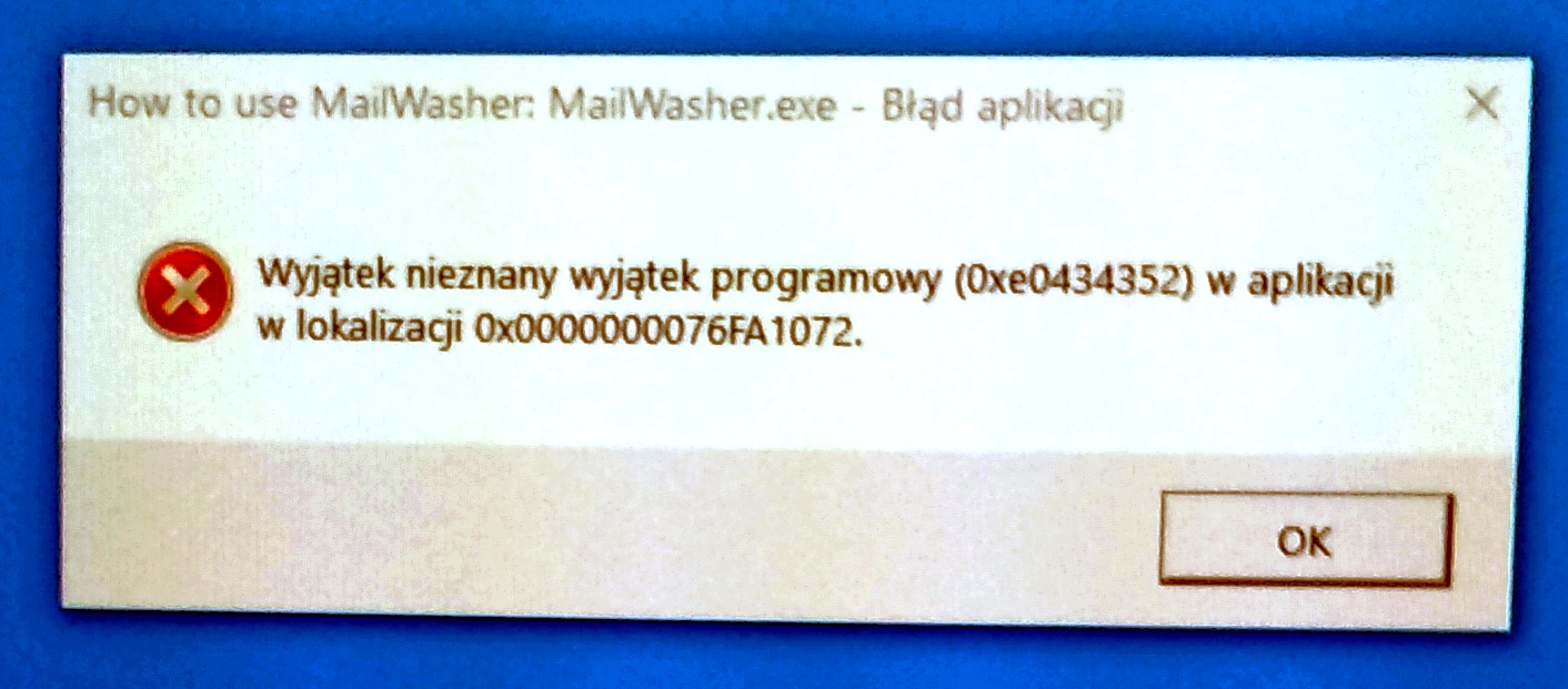

When I switch off the computer, some message is displayed (see attachment) concerning some MailWasher error. What can I do?
- IMG_20240904_000054.jpg (189.04 KiB) Viewed 6388 times

Looks like maybe the startup video window is playing in the background and MW is failing to close this upon shutdown?
Can you click View>>Tutorial Video, is "Show on startup" selected? if so, unselect it and click X to close that screen.
If no better, or that IS already unselected, please try this:
Go Help >> User Files >> close MailWasher so it's not running >> back in the folder you opened right click on startup.xml and select Edit With Notepad (or something similar to edit the file) >> near the bottom of the file will be a line
<PlayAnimationOnStartup>True</PlayAnimationOnStartup>
Change the True to False >> Save the file >> restart MailWasher
