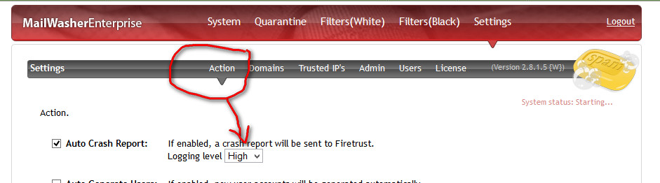

Re: Mail Washer Enterprise Cannot send in local subnet
Thu Jul 17, 2014 5:49 am
Can you switch the logging to High in Settings>>Action screen, and when you experience the problem can you send me the logs from C:\Program Files\MailWasher Enterprise Server\logs
to [email protected]

gene_acres
Posts: 29
Joined: Tue Jul 15, 2014 10:08 am
Thu Jul 17, 2014 6:51 am
Sorry I am not seeing any action screen there.
Thu Jul 17, 2014 6:54 am
Have a look at this
