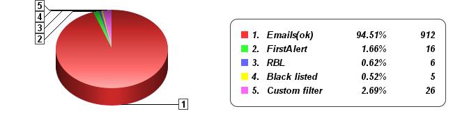

Monday Stats before Upgrade

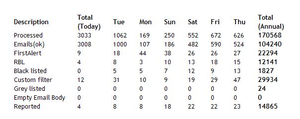

yesterday the daily counts rose to over 10,000.. but after the End of day it seems to have almost corrected itself to about 1,000 processed for Tuesday..and about 200 processed for Monday in the over all counts.. seems the day is off by one day on the overall stats
Overall totals One Day Off

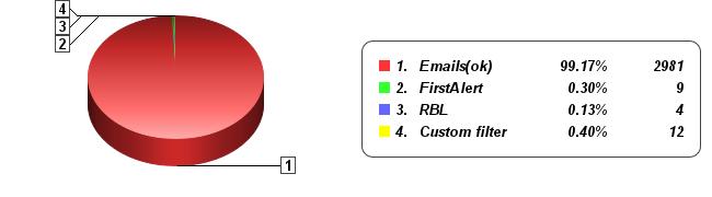

Here it is Wednesday, and it is not even 8:00Am yet, and the daily count is a little over 2,900 processed
Wednesday before 8:00AM
