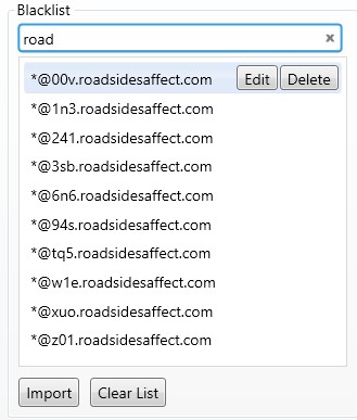

I have these 2 domains that keep coming through and it's fairly common named domains. Not the type with all the numbers and alphabet after the "@"
roadsideaffects. You can see the endless variables it uses. There has to be some sort of wildcards I could use so that Mailwasher could use to see the "roadsideaffects" part and just know nothing else about that name is good and auto-delete.
Another that somehow gets through Mailwarsher, never shows, but is always in my Spam folder on Gmail is "[email protected]" How they do it I don't know but it doesn't show here. I think it maybe once did but not for days now, just shows up in my Gmail and Gmail is not running. Wait, Win10 Outlook is on. Could that be letting it in? Anyway, is there wildcards that can stop this roadaffects and wordgenius. I'll learn from them if someone can help me, maybe images too? Really appreciated any help. jack ":-\\
Annotation 2020-09-05 135032.jpg (35.37 KiB) Viewed 2382 times

Yeah, just blacklist the using the below, you can edit an existing wildcard entry.
*.roadsidesaffect.com
For MailWasher to check the Spam folder in GMail, under Settings >> Accounts >> Incoming >> you need to type to IMAP at the top >> then under the IMAP tab select the Spam folder for MailWasher to check, presently it will only be checking the Inbox folder I imagine.
