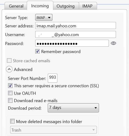

These are my IMAP Yahoo settings, which is working for me at least, using the app password I created.
If you don't use an App password, you must have USE OAUTH checked.

Re: MWP hangs for a good while "evaluating" the last message
I had to delete the OAUTH check. Got it working with IMAP. Thanks.
