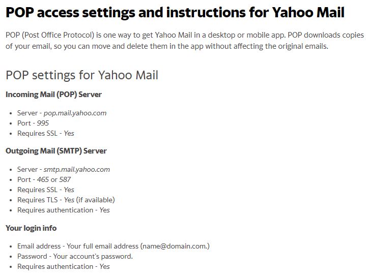

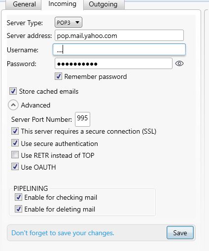

I don't think anything changed in that regard. Here are my Yahoo incoming settings in MWP and Yahoo's page for proper settings, at least the ones that were working in MWP until last week (they still work in my email program, Sylpheed):
https://help.yahoo.com/kb/pop-access-se ... n4724.html
Yahoo problem incoming 9-21-20.JPG (40.19 KiB) Viewed 11560 times
Yahoo POP settings page.JPG (56.79 KiB) Viewed 11559 times

Before seeing your email I had generated a pw at Yahoo's site, but that didn't work either in its 4 x 4-letter groups or all 16 together, even with cache store unchecked. The strange thing is that when I save the original or the changed version, MWP seems to run a connection check and it always shows as successful. What's to be made of that? Could the server address have changed?

Your settings are all OK. Otherwise MailWasher wouldn't be able to get into the account at all.
