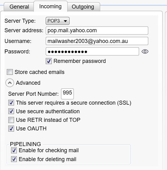

Try first setting the username to be the full Yahoo email address, check the OAUTH option >> Save.
Below is an example of my test account for Yahoo Australia, I assume Yahoo Brazil is the same.
The other option is go to https://login.yahoo.com/account/security or possibly https://login.yahoo.com.br/account/security and down the very bottom there is an option to generate an App Password. If you created an App Password to use in MailWasher, that should also work and does not need the OAUTH option.
When using OAUTH : your regular Yahoo password
When not using OAUTH : use an App Password
