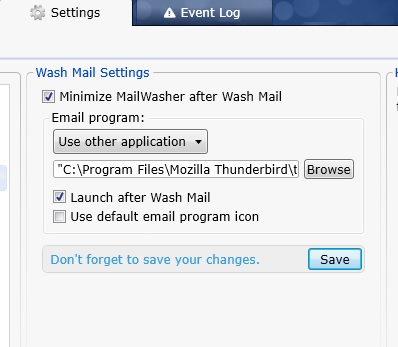

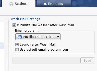

MW 7.12.54 Free, does not open Thunderbird 78.9.1 (64-bit) after washing. I've selected the Default "Mozilla Thunderbird" and have used "Use Other Email Program", which I pointed to the Thunderbird program directly, not the shortcut link. Still does not open Thunderbird after washing. I use Windows 10 Pro 64bit.
Thunderbird default selection
Thunderbird manual entry

If you just hit the ThunderBird button in the main MailWasher screen, that opens ThunderBird all OK or does that also fail ?

Yes, I can click the Thunderbird Icon and it opens.
