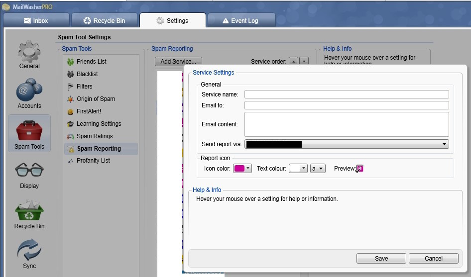

2. Once you've set up your new SpamCop account, in MailWasher, go to the Settings tab, then choose Spam Tools on the left, and then Spam Reporting. Click on Add Service at the top and you will see a window like:
Spam Reporting Setup - 2023_0319.jpg (123.49 KiB) Viewed 1804 times
In Service Name, put something like SpamCop.
In Email to, put the submit.w0l[redacted][email protected] type email address that SpamCop gives you.
In Send report via, add the email account that you want to use to send the spam reports to SpamCop. A Gmail account generally works best.
Click on Save and the reporting service should be set up. You then just need to make sure that the Reporting column is included in the MailWasher Inbox grid so that you can select the messages to be reported.
If you want to test this out to see how the reporting system works, put one of your own email addresses in the Email to field and then report a few emails to yourself.
