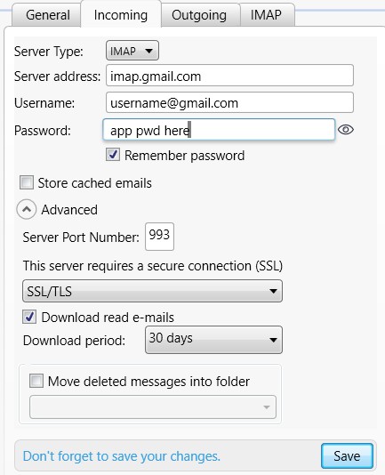

Here's a screenshot of what MW's settings should look like also:
If still problems, and if your settings within MW are correct, yet it still cannot connect, this usually means one of the following.
1.) that your app password is wrong.
2.) you have not yet enabled 2-Step-Verification on the gmail security settings page,
(MW needs this enabled to work with gmail accounts due to changes on gmails end)
https://myaccount.google.com/security
3.) POP and/or IMAP access is disabled for the gmail account, ensure these are enabled here:
https://mail.google.com/mail/u/0/#settings/fwdandpop
4.) Your web browser is incorrectly reporting that 2-Step-Verification is ON, when it is really OFF.... try logging into your gmail account via another web browser, then go here in that browser:
Scroll down and sure 2-Step-Verification is really on.
Aside from that, the only other option is to change your gmail password, use that new password in MWPro, and see if that helps....?
Note also, that after changing your password, you need to first log off gmail within your web browser, restart your PC, then open your
web browser and log back into gmail and re-enable 2-Step-Verification.
