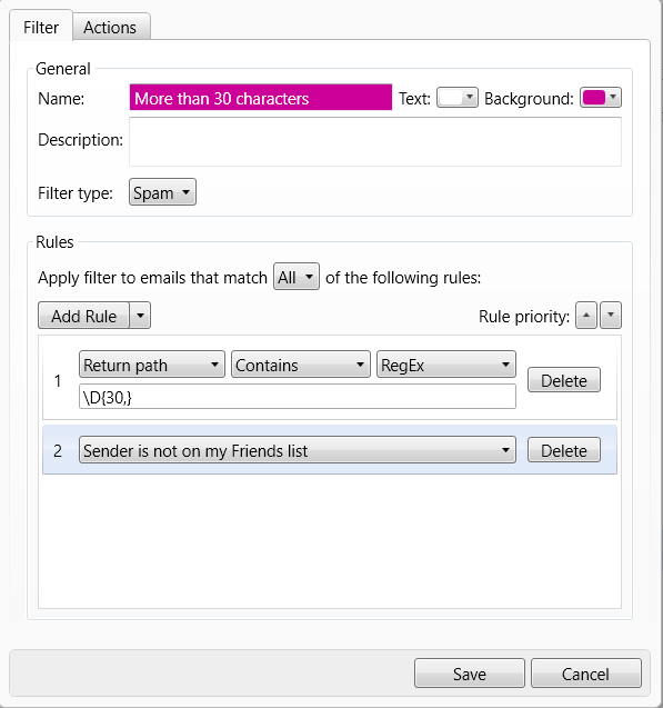

Yes you could create a new filter as below to catch any email with over 30 characters in the from address...? (as per screenshot)
So if the FROM, CONTAINS, REGEX,
@[:alnum:]{30,}
Also add a Spam Tool rule, and set it to be Sender is not on my Friends List and set the filter to match ALL rules.
Doing this so that if you do get a legit sender with very long domain, you can add to Friends list and the filter will ignore any future emails from that sender.
The filter above is looking in the FROM field, for an @ symbol, followed by any alpha-numeric character. The {30,} means it repeats 30+ times.
You can change that 30 number to suit, but keep the comma after the number as this means has to happen at least 30 times, without the comma it would only match if it was exactly 30.
@[:alnum:]{30,}
