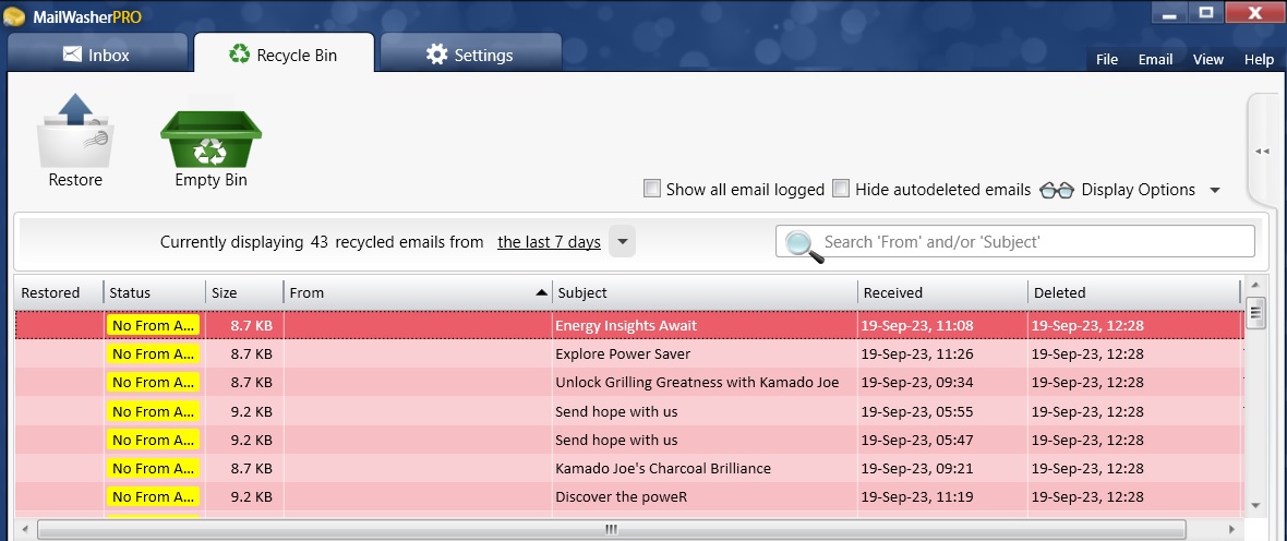

Happy Friday Gingbat,
Never heard back from my ISP even after they assigned a case number. I've tried to use wild cards using the instructions from a different thread that you and RusticDog was on. I tried to recreate the [a-z0-9._%+-]+@[a-z0-9.-]+\.[a-z]{2,4} filter. The email spams are coming from an address similiar to [[email protected]] and [email protected], where the .de and .pl parts are the only constant. I tried *.de, *@*.de and *.*de but the spams keep getting through.
I did notice that there is a SOURCE tab on Mailwasher. Would that be the same SOURCE that you wanted from within Outlook? As it is now, I have been using the Mailwasher SOURCE to identify the "sender" and manually putting that in SETTINGS--SPAM TOOLS--BLACKLIST. That is a pain to do with all the spam emails since Mailwasher will not accept a right click and "add sender to blacklist". I can keep doing this but they keep changing everything except for the .de and .pl parts and its becoming time consuming.
Thank you for the support.

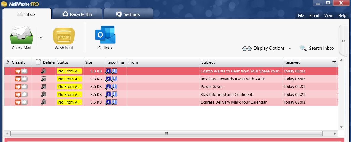

Thanks again Gingbat,
I sent you the no from adress email. The From address is in the SOURCE. That is where I'm manually pulling it from to put in the blacklist. I'm trying the .de to see if that helps.

Great, thanks for that and yes, this email has no FROM address at all, so try the below filter (works for me) and as a bonus, it would also catch any other email without a from address....

Re: No From Address So Unable To Mark As Spam
Fantastic Gingbat,
Can it really be that simple?!!! I certainly hope so. I have already created the filter and adjusted the Spam Score.

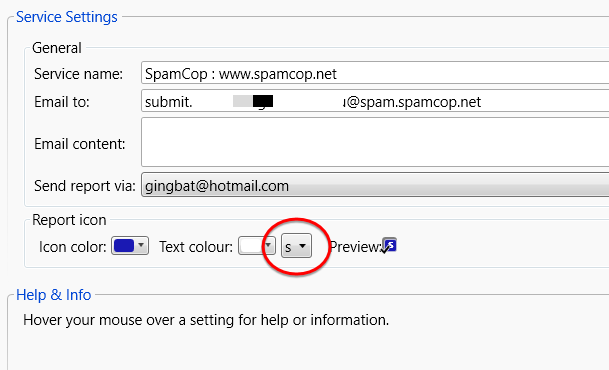

Do you know what the "Reporting" icons are? I suspect that the S is for Spamcop, but I'm not sure about the other...f? I also report to a third, but it is now showing up as being selectable in the Reporting tab. I'm reporting to Spamcop, Spamhaus, and The CBL.

Excellento! and yes, S would be spamcop, F would be whatever is listed under Settings>>Spam Tools>>Spam Reporting, for whatever service you have listed there as per below screenshot...

Okay...got it. Apparently The CBL changed back in 2021 to Spamhaus. I found this:
"Changes to the CBL
IMPORTANT TO ALL CBL users: If you were using the CBL to filter access to your mail servers or anything else, you will need to take note of several changes to the CBL that occured in January 2021. In short, the CBL infrastructure was replaced by the Spamhaus XBL structure, the lookup pages and access methods have changed. Full details on our CBL Cutover page
IMPORTANT! due to the above changes, new users wishing to use the CBL will need to go to for instructions on how to set up the Spamhaus XBL. "
I had already had Spamhaus set up so not sure how I missed this. However, The CBL is still showing up in the drop down list in MailwasherPro. The "f" was for Federal Trade Commission so at least they are getting the report as well.
