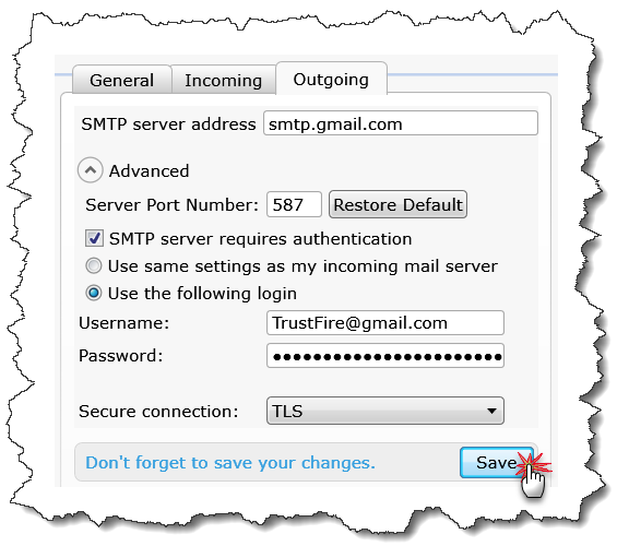

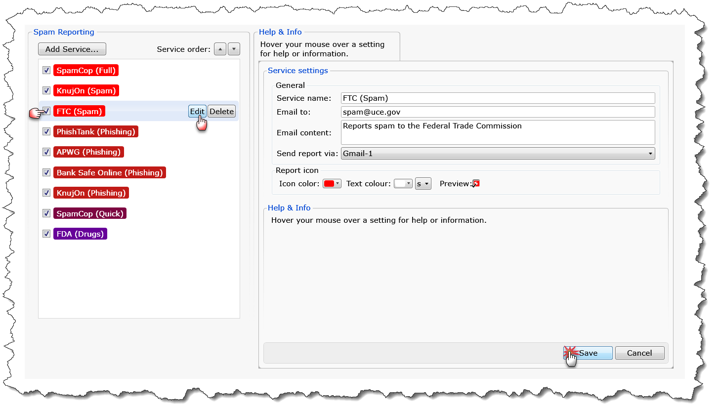

KJ4VOV wrote:Since I am my own SMTP provider I'm 101% sure I'm not doing it. 8)
KJ4VOV wrote:No, Gmail is not an option for me. Thanks anyway.
What help can we possibly offer any individual with this degree of determination. :scratch
Nevertheless . . . . . . if you really need help, do feel free to post the screenshots of your present SMTP configuration with regard to FTC. :thumbsup
ps:
  • In case you decide to post your screenshots, be sure to obfuscate all personal details.
Re: A list of spam reporting services and instructions for MW
Sun May 14, 2017 3:39 am
This is just an illustrative demonstration — not an invitation to use Gmail:—
