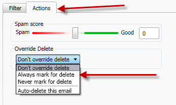

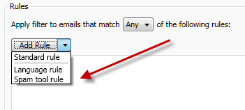

I'm guessing you haven't even looked at the filter or the screenshots folks have posted at this point, that is very frustrating to me.
Rather than continuing to complain why not create the filter that has been suggested and set it the way you want it. The only thing standing between you and having what you want is that you are not willing to do it.

The ability that you want is clearly there. You have complete control over how you want the filter to act.cfheinz wrote:I'm reluctant to set up a Blacklist filter unless I have the ability to still review an item before it is washed.
If it was going to be the exactly the same as the old there wouldn't need to be a new product.cfheinz wrote:I suspect I might be too used to the things were and would like to have a similar process in 2010.

You are likely only going to get out what you are willing to put in. Here is all of about 2 minutes work when you take the time to tell the product how you personally want it to work. It can't read your mind without your input(s). You will get out what you are willing to put in.cfheinz wrote:I suspect I might be too used to the things were and would like to have a similar process in 2010.
