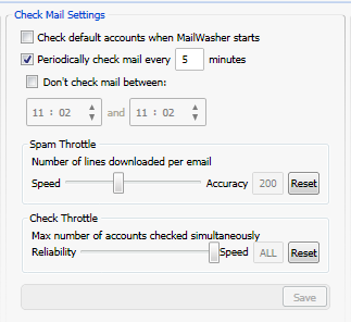

UPDATE: MWP2010 allows you to set the maximum number of accounts checked simultaneously under "Check Throttle" in the General settings, and if you set that to one less than the number of the account order list where the problem consistently occurs, then it seems to fix the problem. For example in my case, I have two different POP3 servers: one acount on one server and 5 accounts on the other. The problem always occurs with which ever account is the fifth one on the server that has 5 accounts. So if I put the 1 account that has its own seperate server at the top of the order, then the other 5 below it, then I can set the maximum simulataneous account checks to 5, and it will never check more than 4 accounts simultaneously on the problem server.

WMP6.5.4 only allowed ALL or 1 at a time, at least 2010 allows: 1, 2, 3, 4, 5, 6, 7, 8, 9, ALL :)

It would be good to get the mail checking options tweaked a bit so that you had the bar we have now for over-all settings but also had an option to limit concurrent connections to the same server to a maximum number. Maybe just a duplicate of the current "Check Throttle" block titled "Single Server Check Throttle" that would limit checks on individual servers but let as many checks as you wanted to be run on different servers.

stan_qaz wrote:It would be good to get the mail checking options tweaked a bit so that you had the bar we have now for over-all settings but also had an option to limit concurrent connections to the same server to a maximum number. Maybe just a duplicate of the current "Check Throttle" block titled "Single Server Check Throttle" that would limit checks on individual servers but let as many checks as you wanted to be run on different servers.
I think the Check Throttle does a good enough job, at least now you can set MailWasher to do say (in this case) 4 accounts at once. Which is a much better feature than ALL or ONE as we had in the old version.
I don't really see much difference in having MW set to check 4 accounts at once, or limited to 4 accounts per server. We'll see how things go, but my first instinct tells me this Check Throttle we have is all we need.
We previously had a hard coded limit in the core engine for the # of current connections per server, but we later took it out as we felt it complicated things. It's best just to let the UI handle the scheduling.
