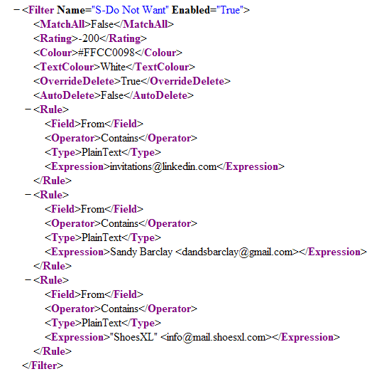

I'd build the basic filter and enter a plain text rule with a dummy expression and one for a regex rule with a dummy expression (include two regex OR conditions so you see how they look) to get the basic format in the file to work with.
Exit both versions of MW to make the file safe to edit!
Make several copies of the rule you are going to work with in the xml file.
Copy the domains you want to block in place of the dummy expression,one per rule for the plaint text option. For the regex option separate them as the dummy did with the | symbol.

Thinking on this more you should be able to open your blacklist.txt file from the old MW and copy/past into the filters.xml file in the new MW with minimal editing, just keep a backup for safety and watch the syntax tags.riovistade wrote:Thanks to Sidewinder & stan_qaz. I had read about the regex method earlier, and I guess I just didn't get it - I do now.
