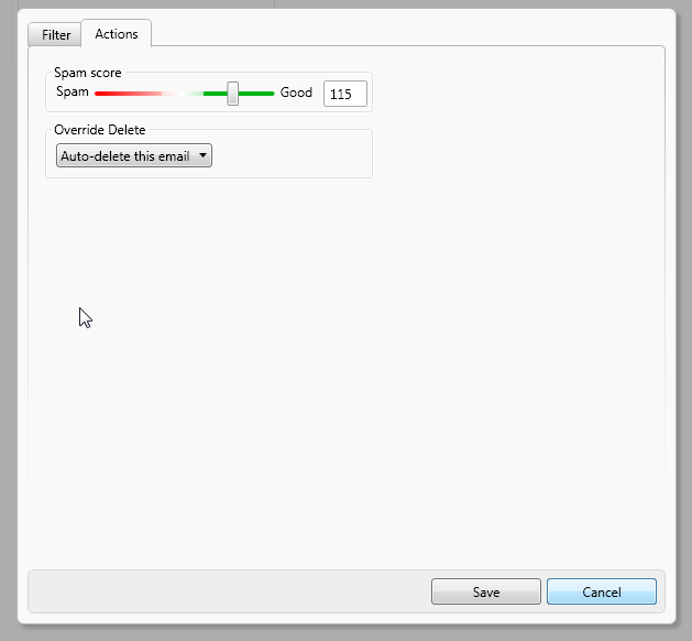

Hi, I have the Language filter set up as shown in the attached screenshots but it doesn't delete the emails that are in Korean or whatever. It labels them as Language and deletes them when I hit Wash Mail. Wouldn't it be good if auto delete meant automatically delete! Or am I doing something wrong?

Why have you given the filter a score of 115?
That's an indication that messages hit by this filter are pretty good and may well be confusing things.

Spam should 99% of the time have a negative spam score ie -100

Thanks. I didn't realise that the spam score was what to assign, I thought it meant auto delete anything below that score. So now I have set it to give any email in foreign languages a -200 score and sure enough it does just that but still doesn't automatically delete the emails. I know that people don't suggest using auto delete but I am confident that all email in Korean will be spam and I want to get rid of it without having to review it. Is that not possible?

Make sure that you have the Filter Actions Tab set correctly to Auto Delete.PhilRose wrote:Thanks. I didn't realise that the spam score was what to assign, I thought it meant auto delete anything below that score. So now I have set it to give any email in foreign languages a -200 score and sure enough it does just that but still doesn't automatically delete the emails. I know that people don't suggest using auto delete but I am confident that all email in Korean will be spam and I want to get rid of it without having to review it. Is that not possible?

It shouldn't matter what score the filter is set to , auto-delete is auto-delete....
The big question would be, is the message that isn't automatically deleted being flagged by the language filter ? Perhaps the filter is simply missing the message ?

Sorry for the slowness of reply. Been out of town. They are indeed being marked as 'Language'. It's all most mysterious!
Re: Surely an auto delete filter should automatically delete?
I've come across a situation that will cause AutoDelete to fail, so we'll fix that up soon.PhilRose wrote:Sorry for the slowness of reply. Been out of town. They are indeed being marked as 'Language'. It's all most mysterious!

Is this the same problem as I reported in the beta forum?
Thread: Bug! v1.0.5 & v1.0.6 Inbox showing auto deleted emails

Yeah, most likley. I was screwing around with FirstAlert and noticed that if I loopback my FA lookups to my machine instead, AutoDeletes weren't firing.

Ah, that's why is stopped happening to me then as I turned off FA!
Mystery solved
