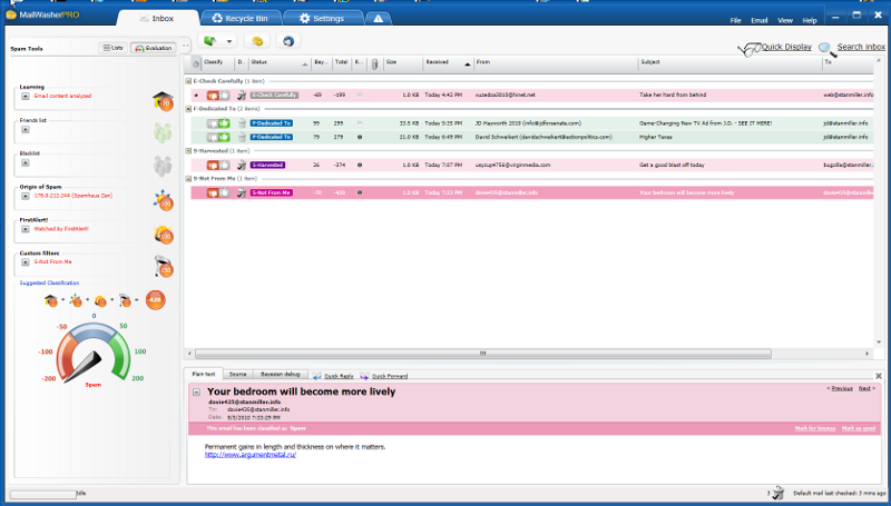

You'll love what MW looks like in a wide window, you can get a full set of columns and the mini sidebar or most of the important ones and the full spam tool sidebar.

The image resized
I had to laugh though....just what are you trying to say Stan.
Re: Filters not imported from MW 6
Don't blame me... You folks are the ones that put that line in a BOLD font, not me!
