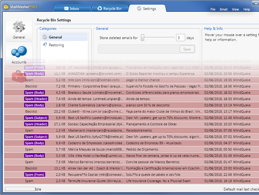

Oops. Sorry for the confusion. I was trying to avoid posting two images.
The upper part shows how I configured the Recycle Bin, and the lower part shows the current content. In other words, it shows what I see after clicking the middle tab on the top, then selected "the last 7 days" from the drop-down. I expected to see at most the past three days, yet I can still restore earlier messages. The column displayed is when the spam was received.

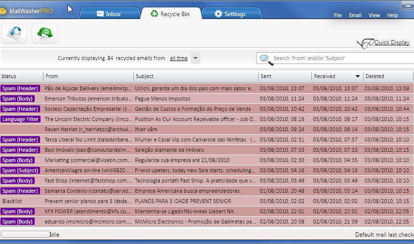

No you've got the understanding of the setting right, however I'm just not sure what actual date is being displayed. If for example you were showing date sent, that might explain it as you may have deleted the email within the last 3 days.
If though that is the date deleted column, then try restarting MailWasher and see if that removes the entries. We do the clear down I think on exit, and there's also a scheduled run I believe that runs once a day. It's possible that this isn't working as it should.

Ok, here are all three columns. It is early in the morning of 8/6 here. The messages from 8/1 are now gone, so they are being deleted. It just seems to be a question of how long these three days are. For example, if the oldest message was deleted 22:05 on 8/2 - then add 3 days, and it would have to leave the list after 22:05 on 8/5. So it might be that messages are being kept a day longer than they should. Not a big problem, I just wasn't sure what was happening.

I don't think time is taken into account, it's simply date.
