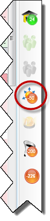

Yeah that's exactly what was happening. I've sent eyeofskye a replacement DNSBLServerList.xml that includes support for his email provider, it will work in the meantime at least.ataraxy wrote:Does your email pass through your ISP's spam filter and does that spam filter add server records to the email headers? If that's the case, then this version of MailWasher won't get an Origin of Spam hit as it will be checking one of your ISP's servers. v6.x is able to look through the entries added by ISP's spam filtering and so is better in this regard.eyeofskye wrote:Nothing on the Origin of Spam or FirstAlert icons. Logs sent as suggested.

Do you have a list that supports Fasthosts as I've never had an Origin of Spam hit, I guess this might be a similar issue

Replace this in the Help >> Common Files folder.anniebrion wrote:Do you have a list that supports Fasthosts as I've never had an Origin of Spam hit, I guess this might be a similar issue

I'll have to see if I get any hits now. 99% of my Gmail is forwarded via Fasthosts so this might be the resaon for the lack of hits there too.

Yes it does add records to the header. Chris has been in touch and I now have been given a modified file for mailwasher that may fix this specific problem.ataraxy wrote:Does your email pass through your ISP's spam filter and does that spam filter add server records to the email headers? If that's the case, then this version of MailWasher won't get an Origin of Spam hit as it will be checking one of your ISP's servers. v6.x is able to look through the entries added by ISP's spam filtering and so is better in this regard.eyeofskye wrote:Nothing on the Origin of Spam or FirstAlert icons. Logs sent as suggested.

eyeofskye if you think that file hasn't helped the DNSBL issue, then wait until more emails received, do another log send. FirstAlert was working fine, so it's just not catching these particular emails.

Thanks RD, I can confirm that I have just seen my first "Origin of Spam" hit using my new DNSBLServerList.xml
- 21-08-2010 9-06-30am.png (21.36 KiB) Viewed 7427 times

It does get overwritten during an updaterusticdog wrote:I cannot recall if it overwrites. I can find out before it should matter.
