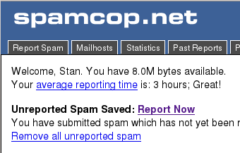

What the report link looks like:
Keep clicking it until it goes away and your report queue will be empty.
