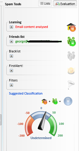

Bayesian takes time, though you have a crap load of emails too, so it should get there very quickly. What I would personally do is process one account at a time, each time you Wash Mail, any emails you train are added to the corpus and the Bayesian is rebuilt. In theory looking at that email volume you should only need to do that once....
If you click View >> Sidebar >> you can get a summary, basically anything -50 or greater is spam, +50 or more is good.
