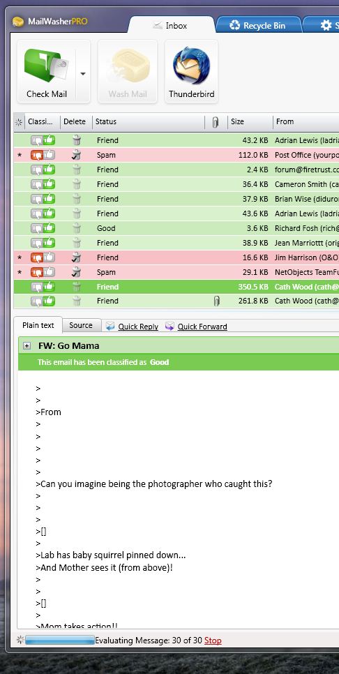

Re: Stuck at "Evaluating Message"
Hi
I assume the last post was for me. It has just done it again so I have sent the logs again to Chris (2) and this is the relevant part of the screen dump after about 3 minutes. Pressing Stop started everything again.
Alan
Alan
- Mailwasher Hang.JPG (85.02 KiB) Viewed 11640 times
Regards Alan
