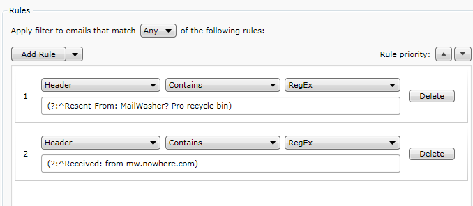

Regex ranges form the incredibly simple to complexity that will leave you in tears. The good news is that almost all you really need to do to trap spam falls to the simple side of the rule.
Here is a good starting point: http://forum.firetrust.com/viewtopic.php?f=50&t=5642
Try: "Subject does not contain regex ." which will pick up all messages with a blank subject. That was my sole regex filter for many years.
Switch to regex mode and ignore all of the other options aside from the few characters that need an escape code "\" ahead of them.
http://www.regexlab.com/en/deelx/syntax/bas_sesc.htm
Use the wildcard options "." which matches any single character ".+" which matches at least one character and as many as possible or ".*" which is similar but also matches zero characters.
http://www.regexlab.com/en/deelx/syntax/bas_quat.htm
I'm finding that I can code some fairly powerful checks into fairly simple to create regex structures and they are actually less work to maintain and run faster than plain text ones. That is interesting as 2010 optimizes plain text filters when it can and then converts all filters to regex code for internal use. Looks like the friends and blacklist also use regex for internal use too.
This one is a re-do of the recycle filter looking for faster processing the "(?" makes it a non-capture group that is supposed to be faster and the "^" restricts checking to the beginning of the line eliminating having to check beyond the first non-matching character.
Wait on the more complicated stuff until you have time or need it but the simple wildcard options are worth learning and using up front.

Not a problem, I posted the details not only for you when you get time but for anyone else coming across the topic and needing help.
It is good for new users to post problems to rusticdog (aka Chris) as a lot of stuff only gets hit by the internal firetrust testers and new users, many of the beta testers never go back and do a new install tossing all of their data and therefore miss stuff like you caught.
You might be able to cut a deal with Chris, free software or something in exchange for some good Swiss chocolate, he is married and that stuff can come in quite handy when the wife isn't happy.
