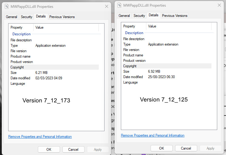

I am having the same issue where MailWasher crashes and creates a dump file, in the crash logs it states the following DLL "MWPappDLL.dll" as causing the exception.
I've looked at my daily PC backups and can see this DLL was changed in the new release as the new file is smaller.
As stated in the thread the only approach that works for me is to revert back to the previous release "7_12_125", I don't wasn't to disable any of my rules or firstalert as these were created for a reason.

- 2023-09-03_093218.jpg (90.54 KiB) Viewed 6674 times
