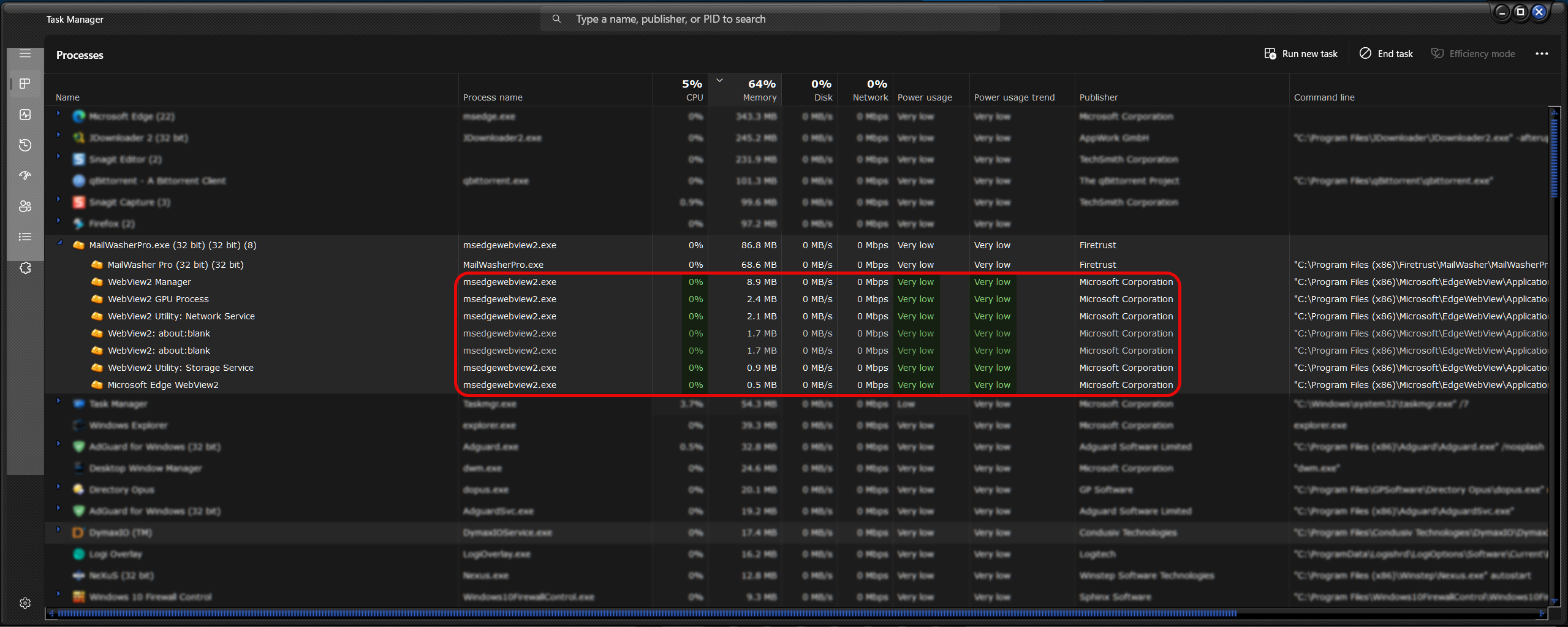

I noticed that MailWasher Pro v7.12.125 was released today and I was quite pleased when i saw this in the changelog:
  • Fix: WebView processes never close
  • Fix: WebView control is no longer valid
So you can imagine my surprise when I saw this while MWP was minimised to the system tray:Image
Even I write this post, the Microsoft Edge WebView2 processes remain in Task Manager. Perhaps I am misinterpreting the changelog or I have a rogue setting in MWP causing this problem to persist?

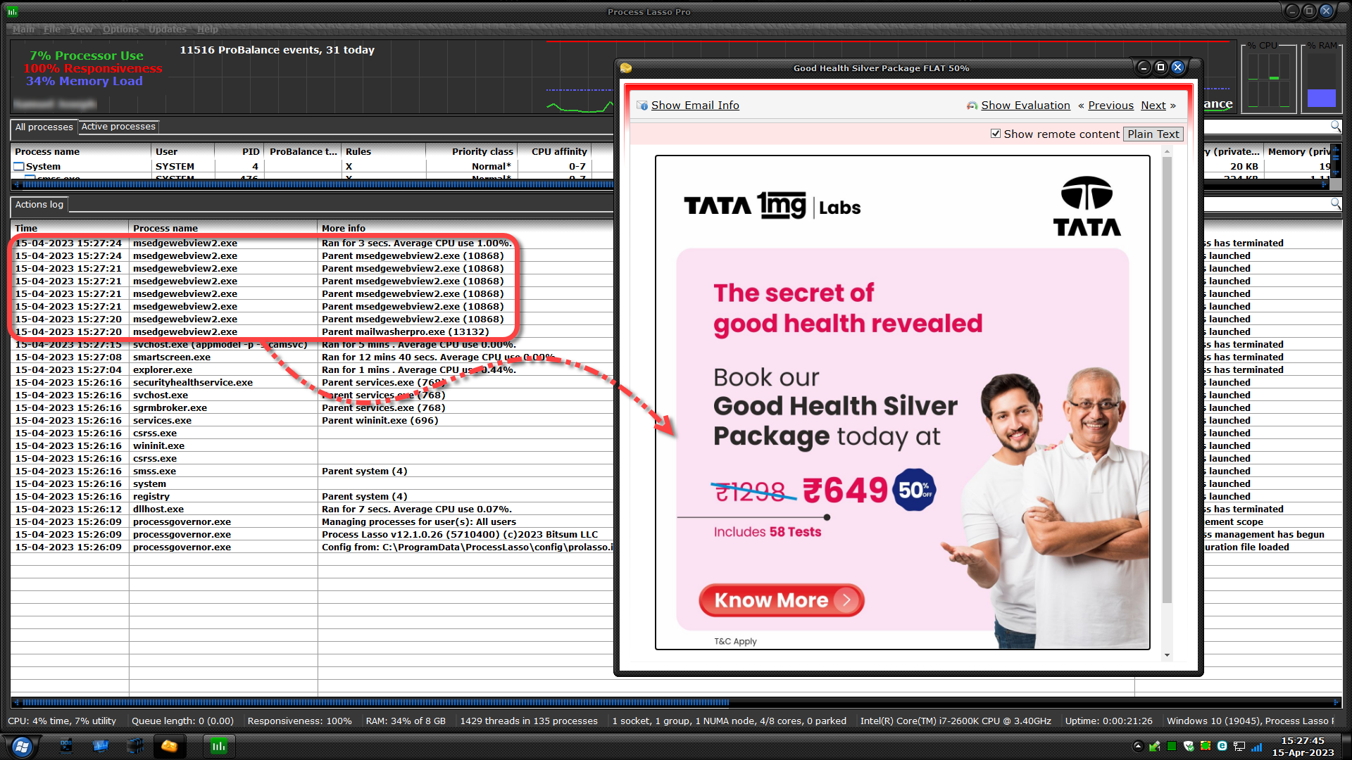

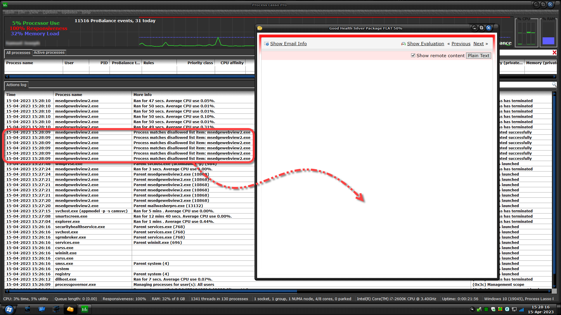

For me . . . the HTML engine of MailWasher ceases to render HTML as soon as the Microsoft Edge WebView2 instances are terminated the very moment the process msedgewebview2.exe is blocked (as also demonstrated by the following 2 illustrations.)
At every subsequent MailWasher startup . . . if the process msedgewebview2.exe continues to be left blocked, my MailWasher comes crashing down (without warning . . . or, even a prompt to log the usual crash report) whenever I try to view an HTML content . . . at the stage where I click the Download Full Email button.

I checked my task manager for msedgewebview2, and saw that simply opening Mailwasher Pro, without checking for mail, spawns 7 instances of that process, but draws 0 cpu. Closing MWP ends all 7 processes. Downloading the full HTML and remote images did not add any load at all.. But, I only have one email at this time.
I am doing this from regular my Standard User account, not an administrator account. I will have to log out and into an admin account to see if it makes any difference in cpu usage.
