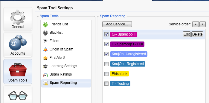

Add the spamcop service here by clicking the "Add Service" button

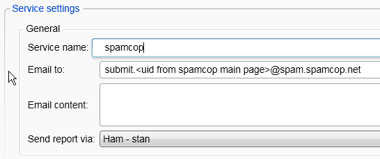

Fill in the blanks here, "Service Name" is anything you'd like, "Email To" is your unique e-mail address assigned to your spamcop account - copy it from the spamcop.net page, it follows the "Forward your spam to:" line. For spamcop.net reports the "email Content" field must be blank. Pick any of your SMTP servers to send via.

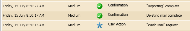

Once you are setup and send in a report you should see this sequence on the MW log tab.

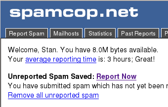

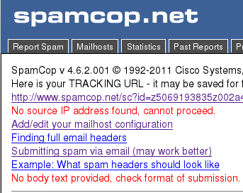

You can confirm the message got to spamcop by logging in, you will either see error messages there or a reporting link will appear.

When I try to enable Spamcop in settings, I get the message "You must enter your unique Spamcop reporting address.".
How do I enter it and am I to enter the email address I'm using in Spamcop.net or do I use my Spamcop.net password?
Carl Heinz
Re: How To: Spamcop.net reporting v 1.2
Mon Jun 27, 2011 4:50 am
cfheinz wrote:When I try to enable Spamcop in settings, I get the message "You must enter your unique Spamcop reporting address.".
SpamCop issues each user with a user unique email address that begins with "submit." That is what you put in the "Email To" setting in MWP.

I hate being obtuse, but the current value in the Spamcop "Mail to" is "submit.[uid]@spam.spamcop.net". I assume I'm supposed to insert something in "uid". The only things I've received from Spamcop are my userid and password. I have set up my home email address. Do I just insert my userid in the "uid" space?
Carl Heinz
Mon Jun 27, 2011 5:34 am
If you log into the SpamCop web site with your id info and the go to the Report Spam tab you will find the line "Forward your spam to:" with the complete entry that you need for MWP.

Thanks. That appears to have worked.

cfheinz wrote:I hate being obtuse, but the current value in the Spamcop "Mail to" is "submit.[uid]@spam.spamcop.net". I assume I'm supposed to insert something in "uid". The only things I've received from Spamcop are my userid and password. I have set up my home email address. Do I just insert my userid in the "uid" space?
After you log in to spamcop at http://www.spamcop.net/mcgi?action=loginform with your UserID and password, you'll find your unique submit..... e-mail address (the one you should submit in MWP) somewhere on the bottom of next page of the Spamcopsite.
