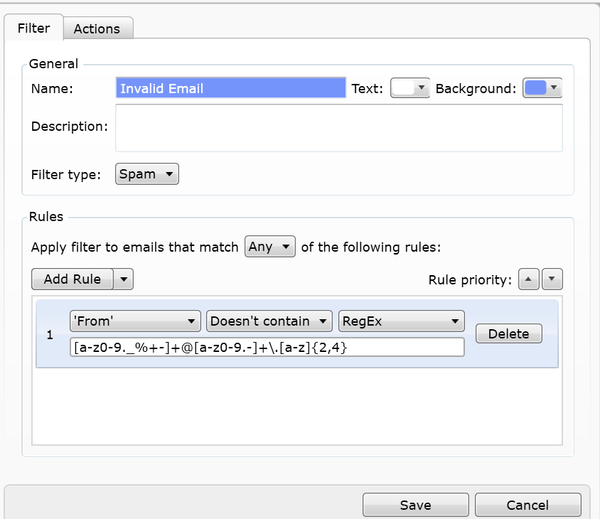

MailWasher won't add an invalid email address to the blacklist, and these emails break the rules.
What I have is a filter that ought to tag these emails as well.
It looks at the FROM field, DOESN'T CONTAIN, REGEX,
[a-z0-9._%+-]+@[a-z0-9.-]+\.[a-z]{2,4}
You could try this, and assuming it works well if you don't want to see the emails you can set the autodelete under the Options tab for the filter.

Working like a charm.
Thanks again.
