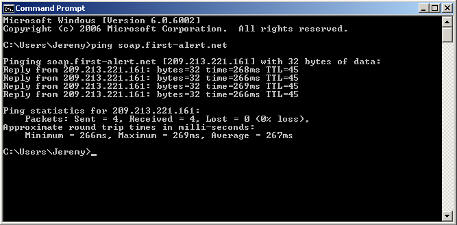

If all OK now, either leave as is, or re-enable it and see if you can find out where it is blocked, check your firewall settings to ensure port 4050 is not blocked... here's how to test the Firstalert connection too....
1.) Click, Start >> All programs >> Accessories >> Command Prompt, type in or paste:
ping soap.first-alert.net
And copy and paste the contents of what happens into your reply, it should look similar to the below screenshot.

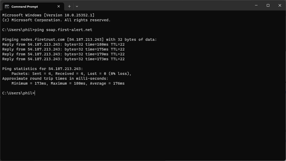

Morning,
I've unticked first alert and will leave it for a while and see, my ping result:
Phil
Re: Stuck on Evaluating
Sun Apr 30, 2023 5:37 am
Sure thing, looks fine, so yes, see how leaving disabled goes....
