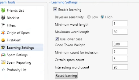

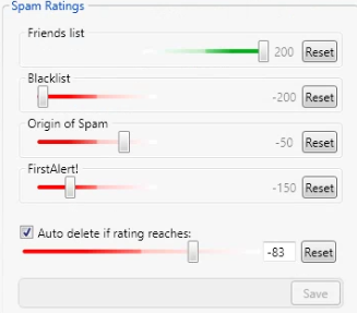

That brings us back to the auto-delete setting for the Learning, what was that set to ?

Re: Spam evaluation - detailed information
Thank you for taking the time!
Please find attached the screenshots
(PS! I am leaving for a meeting now)
- screenshot3.PNG (38.57 KiB) Viewed 5159 times
- screenshot2.PNG (58.67 KiB) Viewed 5159 times
OK great, so that Good Token Weight looks like it's set to 0.00. Can you set that to at least 2.0 >> Save >> restart MailWasher >> check that the change saved.
Then you can also see the auto-delete rating is currently set to -83, so pull that slider back to -140 to start with. You'll then see less emails in the Bin and more in the main screen, where you can correct the training. After a couple of days assuming MailWasher is getting it right identifying the spam and good, try moving it down to -120. Just see how that goes for a while.
