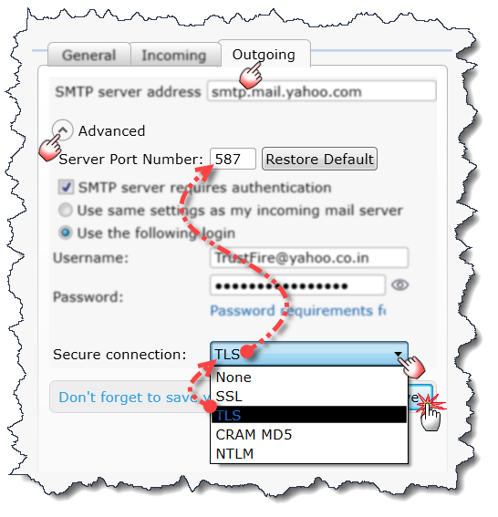

For the purpose of reading "received" mails . . . neither does MailWasher use TLS nor does Outlook — in other words . . . TLS has no role in inbound traffic.
TLS comes into play only where mail-sending (outbound traffic) is concerned . . . by default, MailWasher uses SSL (over port # 465) instead of TLS — however . . . if you want to use TLS for sending mails, you will need to re-route your sending (outbound traffic) through port # 587.
TLS is a port-specific SMTP connection — it's working fine, here . . . as usual. ;)
