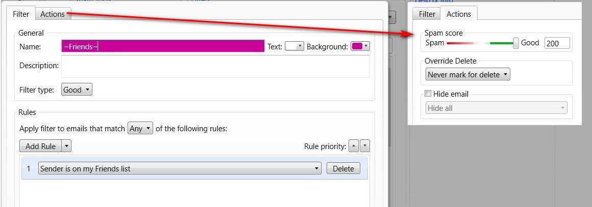

One way around this would be to set a filter to catch all emails on your friendslist, (Settings>>Spam Tools>>Filters>>Add Filter>>Add Rule>>Spam tool Rule) that way it would be displayed with the filter name, eg, you could setup a filter like the below:

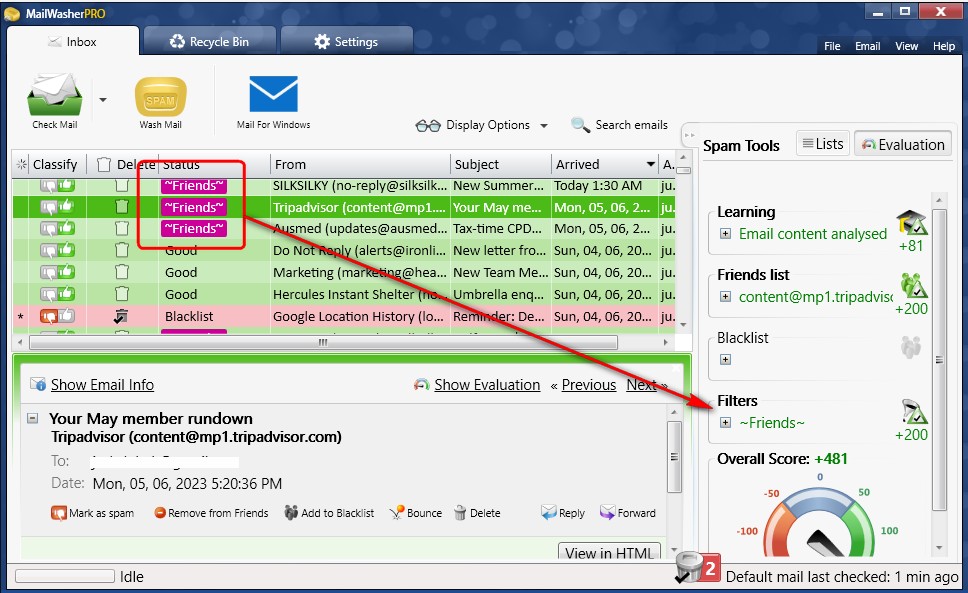

Then your emails would display like this if on your friendslist:
- phred
Re: Color for Marked as Good
That's great gingbat. You may consider this a work-around, but I consider it a solution as it does indeed make the "good" emails stand out from the rest.
Thanks!
Thanks!
- MW147
