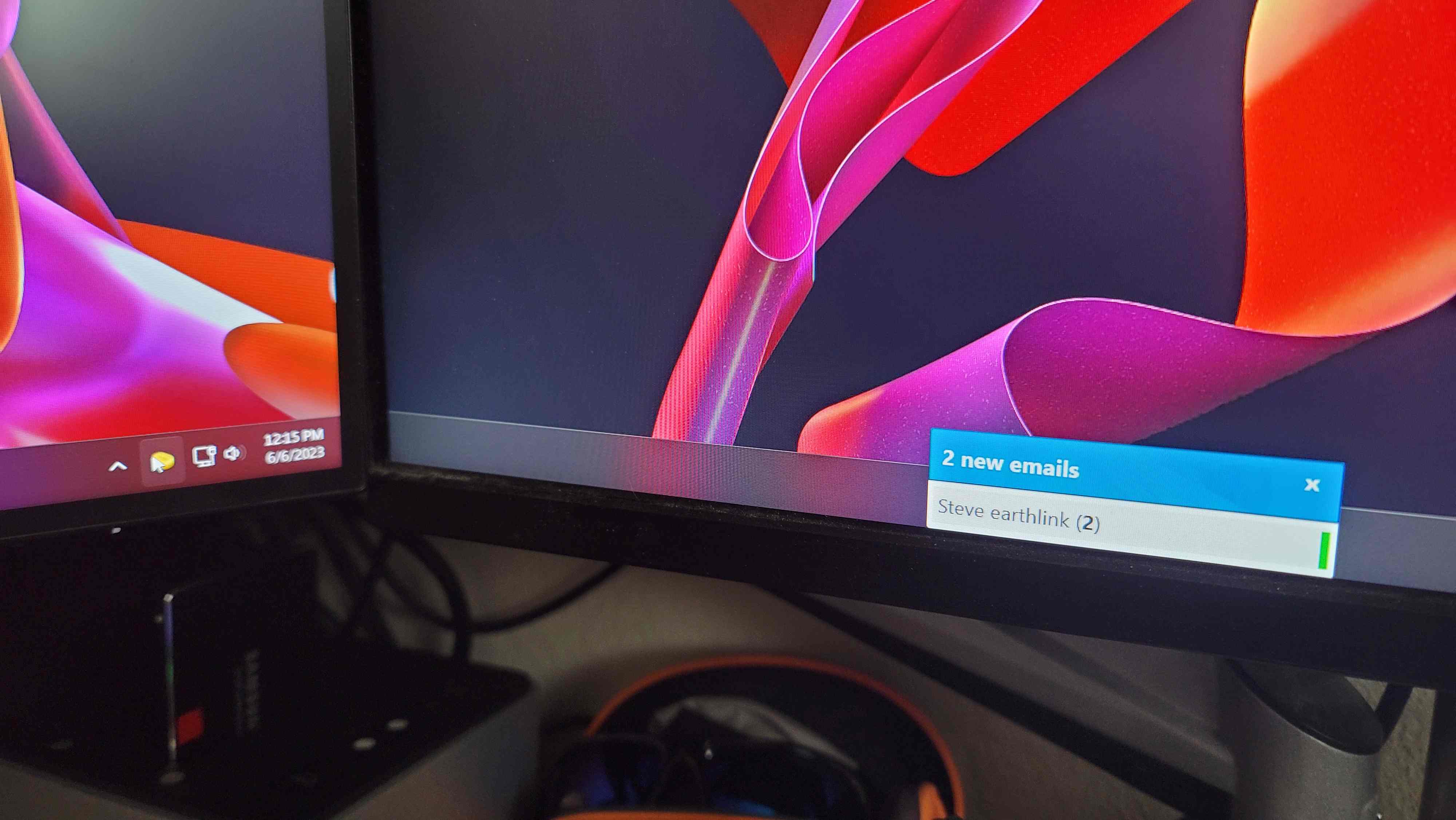

I had to replace a broken hard drive. I do export backups weekly so I had the file on a separate drive.
After re-installing mailwasher pro 7.12.125 on my new drive and importing the settings file all is working as it should.

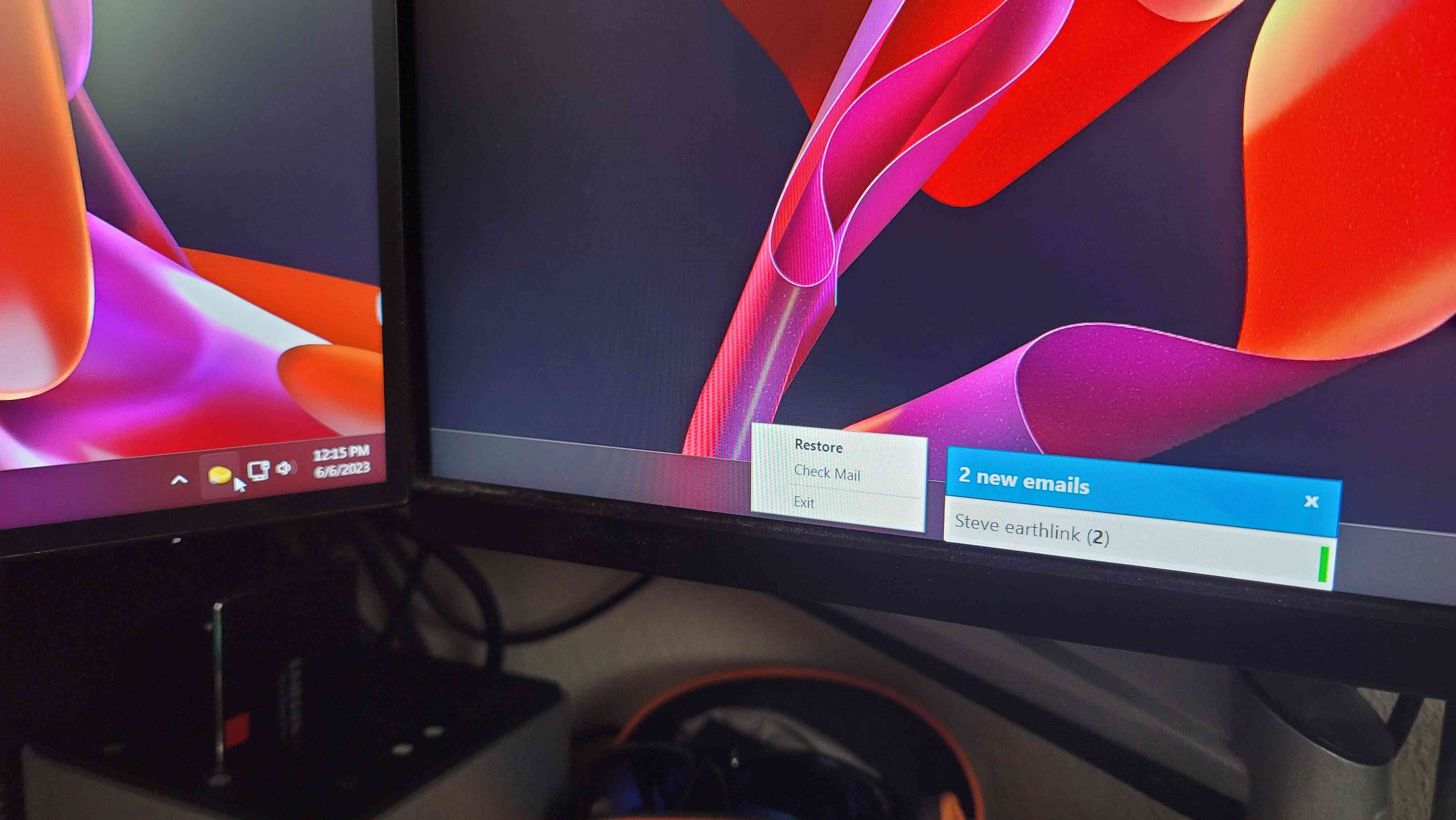

Except, the notifications are now 6" to the right on my second monitor. I uninstalled and re-installed but with the same results. If I turn off the second monitor I can't the notifications. This is for both right click and new mail.
Any suggestions?
Notifications off to side
- Avspinball
- 2023-06-06 12.15.45s.jpg (302.27 KiB) Viewed 4657 times
- 2023-06-06 12.15.41s.jpg (318.78 KiB) Viewed 4657 times

It just doesn't seem to be in the right place, about 15cm to the right. I actually have three monitors and can move the task bar to either but the same issue of 15cm to the right.

I thought it was the scale setting on windows. I had it at 125% and just moved it to 100% and it was correct. Started typing that it was fixed but checked again and it's not. I'm pretty sure it has something to do with windows scaling. I might try a reinstall again tomorrow with windows set to 100

The problem has been known for many years. Together with user “rhb” I wrote about it back in 2019: viewtopic.php?f=50&t=28954
But it's a little better now.
Today I installed version 7.15.10. I installed directly on the old version 7.12.188, I did not change the configuration of the program. In version 7.15.10, the context menu is displayed on the main monitor. However, the new mail notification still displays on the secondary monitor.
Windows 10 scaled up to 200%, two monitors 1920x1200.
