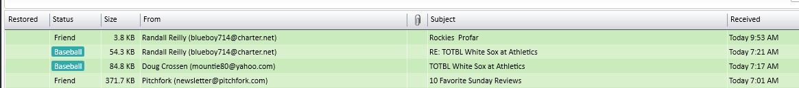

Here is a screenshot. I am trying to restore emails from the email that my FT forum account is registered to which is the same as the one I've been emailing you from.
Do I need to have something checked in my account settings to create this missing file? I have the setting set to store deleted emails for 21 days and the restoring is set to the fallback account that I mentioned above.
Do I need to store cached emails in my account's store cached emails?

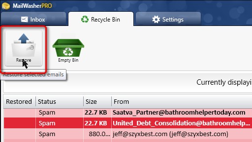

- Open MWpro and click the Recycle bin tab,
- Click on an email, then click the "Restore" button
- Wait 10 secs or so to be sure the process has completed,
IF you never get the email, OR there is an error,
- Click "Send Logs"
Then, reply to this to let me know the logs have been sent in case they do not arrive for any reason...

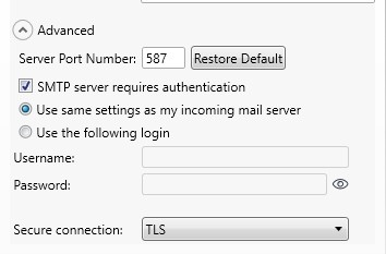

Got them perfectly thanks, and yes, the issue seems to be you are using port 587 (the TLS port) but don't have TLS enabled.
Currently account settings show:
<OutgoingServer Type="SMTP" Port="587" Security="None" AuthType="UseIncoming">
When they should be:
<OutgoingServer Type="SMTP" Port="587" Security="TLS" AuthType="UseIncoming">
In MWPro click, Settings>>Accounts, click the account you want to restore mail from, click the Outgoing tab >> Advanced, click the "Secure Connection" button and select TLS.
Click Save and try restoring another email....
How did that go?
How did that go?

Still not working after changing the settings. I get an error log message (I changed my email to xxxx)
Description: An unknown error has occurred. MailWasher is unable to determine the cause of this error.
Diagnosis: <EVENT><NAME>MWPEXCEPTION</NAME><ID>15b05e7da880ddddfa25390d804a7c54</ID><DT>2023-08-27 16:04:22</DT><MWPEXCEPTION><UID>Exception ff4c58187732f46247c6c71a9ffd94f1</UID><AID>*</AID><SOURCE>SMTPservice::SendEmailList</SOURCE><MESSAGE>StdException - ChilkatLog: SmtpNoop: DllDate: Jul 23 2023 ChilkatVersion: 9.5.0.95 UnlockStatus: 1 Architecture: Little Endian; 32-bit Language: Visual C++ 9.0 (32-bit) VerboseLogging: 0 ensureSmtpSession: ensureSmtpConnection: smtpParams: SmtpHost: xxxxxxxxxxxxxxxxxxxxx SmtpPort: 587 SmtpUsername: xxxxxxxxxxxxxxxxxxxxx SmtpSsl: 0 StartTLS: 1 --smtpParams smtpConnect: smtpHostname: xxxxxxxxxxxxxxxxxxxxx smtpPort: 587 connectionIsReady: SMTP host changed. SMTP port changed. Need new SMTP connection... --connectionIsReady smtpSocketConnect: socketOptions: SO_SNDBUF: 262144 SO_RCVBUF: 4194304 TCP_NODELAY: 1 SO_KEEPALIVE: 1 --socketOptions --smtpSocketConnect smtpGreeting: readSmtp</MESSAGE><ADDXML><TYPE>SMTPSENDLIST</TYPE><HOST>xxxxxxxxxxxxxxxxxxxxx</HOST><PORT>587</PORT><ACCOUNT_TEXT>Restore</ACCOUNT_TEXT><ACCOUNT>*</ACCOUNT><USER>xxxxxxxxxxxxxxxxxxxxx</USER><LOGINTYPE>9</LOGINTYPE><SSLMODE>0</SSLMODE></ADDXML></MWPEXCEPTION><ORDINAL>0</ORDINAL></EVENT>
