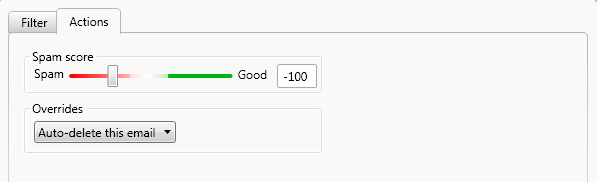

You can set up a filter with the Spam Tool Rule "Sender is on my blacklist" and on the action tab in overrides choose "Auto-delete this email"
Re: Blacklist deleting automatically
Fri Jul 09, 2010 11:12 pm
anniebrion wrote:You can set up a filter with the Spam Tool Rule "Sender is on my blacklist" and on the action tab in overrides choose "Auto-delete this email"
Also click on Actions Tab and then Overrides to select the Delete Action that you desire.

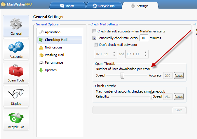

Just a couple of words of caution about using the Automatic Delete option(s), e.g. overall setting based on Total Evaluation score or Filter, Rule based.
Messages downloaded into MWP2010 from the mail server are most likely only partial messages. This is dependent on the user settings shown in the screen cap.
Since the overall performance is altered by the number of lines for each message there is a tendency to reduce it. The lowest suggested setting is 80 lines.
If you enable the auto delete option(s) when it gets triggered the message is moved to the Recycle Bin and deleted from the mail server without further user action.
If the user then discovers that a critical or otherwise wanted message was inadvertently auto deleted they can go to the Recycle Bin and perform a Restore. Just keep in mind that the Restored message will only contain the number of lines that were downloaded based on the Spam Throttle setting. You may be able to use the fragment to get back to the original sender and request a resend. That is not always possible. You also need to alter the settings so that you don't get a repeat auto delete the second time.

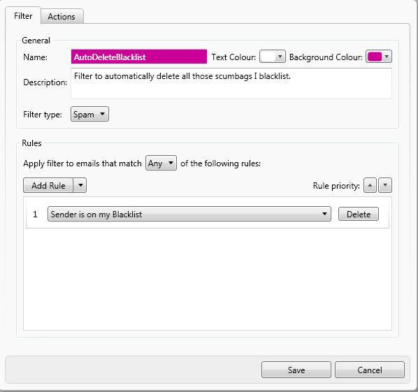

Can you post a screen grab of your filter settings?
Do the emails have the filter name as their status in the inbox?
Sat Jul 10, 2010 1:29 am
I had one ready to go :)
It should look something like this....

Thanks all, yes, I have adjusted this. Mails only are displayed as a blacklist but not deleted.
Sat Jul 10, 2010 2:43 am
steve1 wrote:Thanks all, yes, I have adjusted this. Mails only are displayed as a blacklist but not deleted.
Because they display as Blacklisted and not displaying the Filter Name in the Status field, that implies that the Filter simply isn't matching those emails.
Can I ask, the blacklisting entry is just a standard email address, not a wildcard etc.. ?
