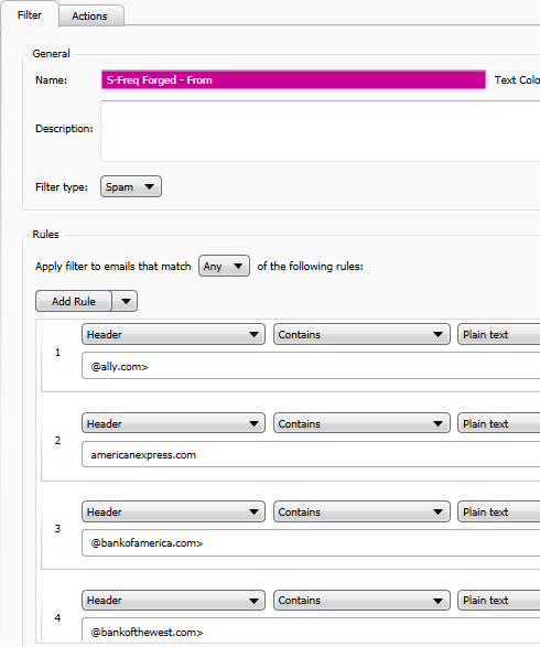

I'm not a fan of doing that myself since it would add hundreds of bogus addresses to my blacklist that would just clog things up, I much prefer adding just the ones that come time and again to a filter titled "Do Not Want" so that I can group the display by Status and have them all sitting in one group that I can collapse and ignore. You could also set that filter to auto-delete and never have to look at the stuff unless you wanted to save it for spamcop reporting.

I filter them, give them 200 bad points and group on the filter name. Better to have them grouped than mixed in with other mail and in my way. I save the blacklist for addresses that might be good, mostly wildcards for country domains.

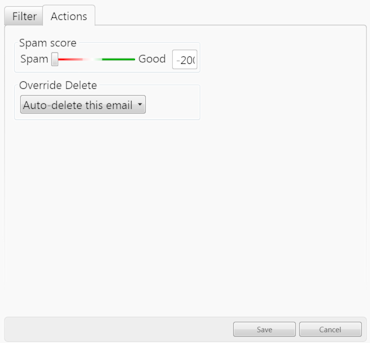

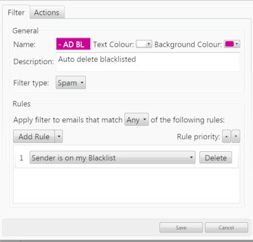

People that do can set up a filter that is "Spam Tool Rule" >> "Sender is on my Blacklist" & the action "Override delete" = "Auto-delete this email".

If you want blacklisted addresses to always be deleted create a filter and set that as the rule using the drop-down option on the add rule button. I think you can choose to just mark or auto delete.
