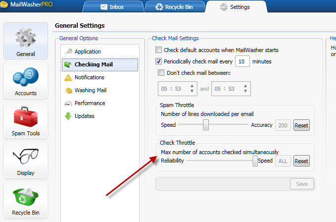

Here is the Throttle Setting that Stan posted:
Here is the Pipelining setting:
If these don't work follow the instruction regarding posting the logs.I am not a Firetrust employee. Just a MW User & Volunteer BETA Tester.

Another thing you could try is setting the Check Throttle to just one account at a time under Settings >> General >> Checking Mail.
