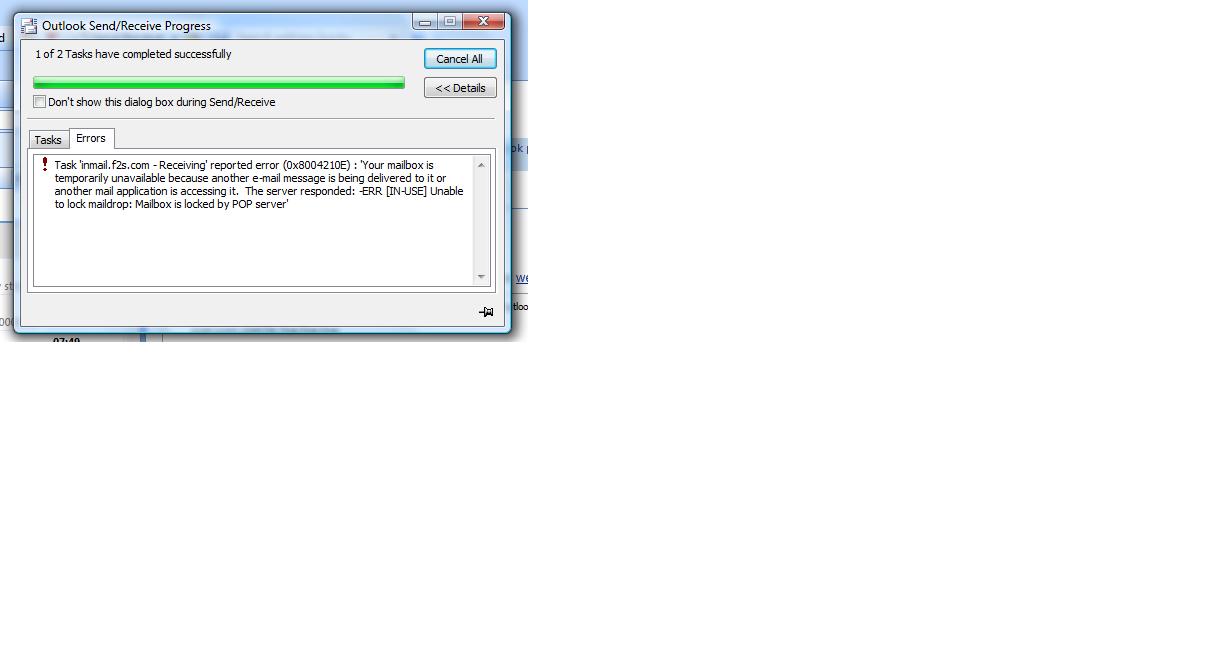

I've disabled the pipeline, but now Outlook won't send/receive - please see attached screenshot.
- Error Message Outlook.jpg (46.85 KiB) Viewed 9601 times

I'm also now getting a warning triangle next to settings and "unknown error"...

Might be a problem with my ISP server as am getting an error message on webmail too - typical!
Re: I need to exit and reopen for emails to be checked
Sure thing. Once you've contacted them to get that sorted let us know and we can come back to the main problem.johnnybgoode wrote:Might be a problem with my ISP server as am getting an error message on webmail too - typical!

Latest update - have reset the pipeline checkbox and all is working ok again. There are 5 "old" emails that refuse to be deleted from my webmail inbox so have asked my ISP to do this. I will then retry removing the pipeline checkbox, but it works at the moment (at least when I'm logged in)...
