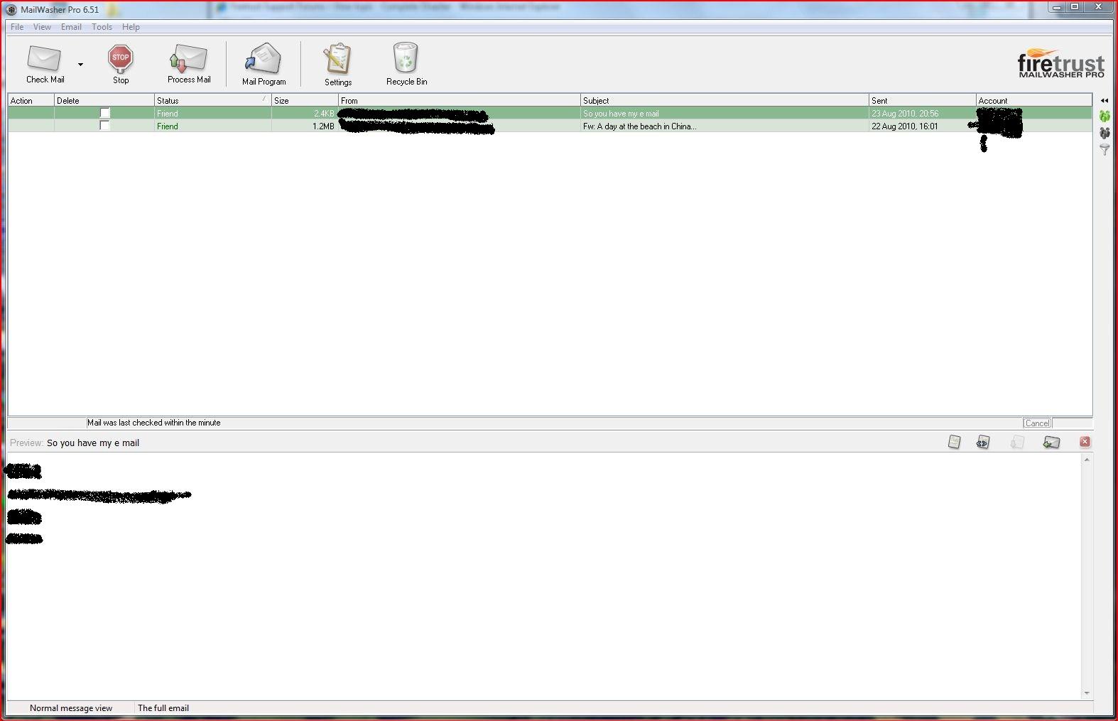

I have attached a screenshot of MW 6.5. The settings will have been taken from those for 4.5 I anticipate?
Re: Complete Disaster
Yes.rusticdog wrote:By an chance do you have your TaskBar set to the top ?
- Capture.JPG (114.37 KiB) Viewed 5153 times
Sorry I meant the main Windows Task Bar, with Start button etc...
Either way, give this version a crack, the beta testers aren't cranky about it, so it seems good to go....
