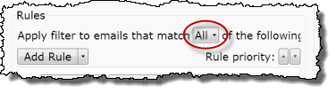

Do you have the rules set to ALL?
- 26-08-2010 2-56-23pm.png (16.92 KiB) Viewed 7281 times

Thanks for replies: Yes, I do have it sell to ALL. Have actually tried it both ways, ANY and ALL and they both seem to work the same
