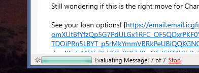

Is there any other steps. It seemingly hangs at the end of every evaluation.
When I press stop, it takes about 20 seconds before Wash Mail is available, and the <Stop> sign is long gone from <Check Mail> So, it's cramping my style!
Also, somewhere down the line, it takes MW 6 or 7 seconds from loading the program to 'Check default accounts when MailWasher starts' I don't know if that's a clue or not, but always till then it started checking immediately.
