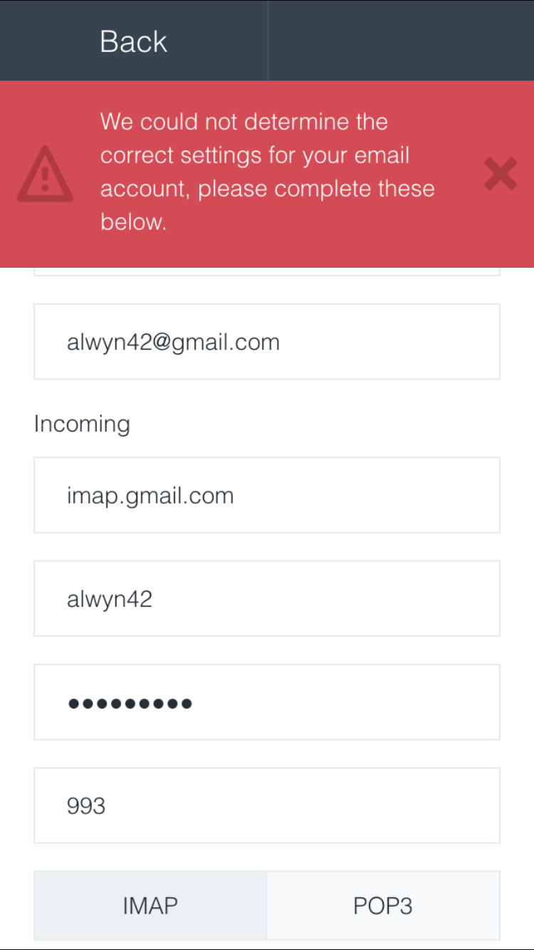

Thanks Nick.
I checked everything you said and Mailwasher is authorised and Less secure apps is ON.
Still I cant set up my Iphone, (I haven't tried the IPad).
Attached is the error message

Ok, the username alwyn42 needs to be your email address [email protected]

I tried that and it makes no difference. The settings are exactly as I have both on my PC and my IPad and IPhone but they do not work any more in mailwasher.
