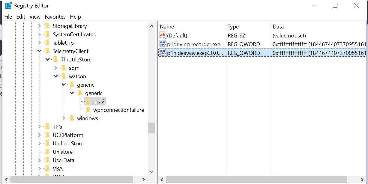

I have searched the registry and have come up with this reference. The "Driving Recorder" exe file is software for a digital dash cam which is in use regularly so I don't know whether I can safely delete the Hideaway reference or not. Snapshot below. I am not that au fait with computers that I will mess around with the registry so will take your advice.

- HW Reg..JPG (87.23 KiB) Viewed 5363 times
